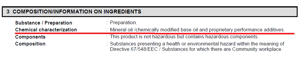

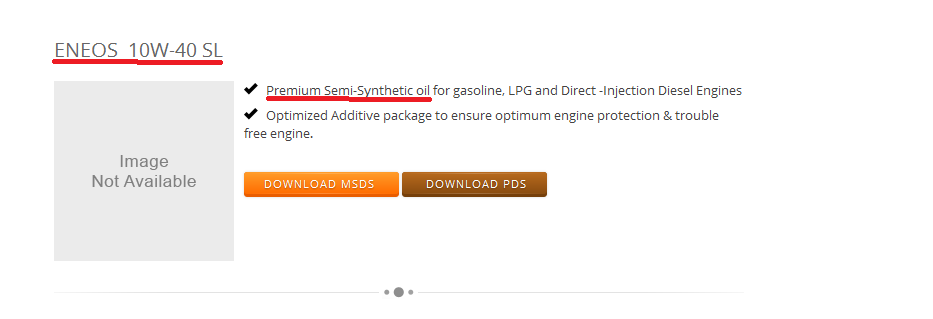

Wolfman Posted February 25, 2013 http://eneos-bulgaria.bg/filesProducts/11_20120517134844_Eneos-Bulgaria_EneosPremium10W30.pdf http://www.enpo.eu/mediaupload/pdf_files/ENEOS_Premium_Hyper_5W40.pdf http://www.enpo.eu/mediaupload/pdf_files/Sustina_5W30.pdf Share this post Link to post
matizdepitesti Posted February 26, 2013 Nu ai dat nimic concret acolo, doar datele de manipulare a uleiului. Uite inca odata 2 link-uri, in care scrie clar ca este sintetic: - http://www.noeu.jx-group.eu/product/pdf/PB-ENEOS-10W40.pdf - http://www.eneos.ro/index.php/produse/uleidemotor/eneos-premium-10w40-ulei In primul pdf scrie clar "ENEOS Premium 10W40 is blended from synthetic base oils and optimized additives, so its high-temperature oxidation stability is superior to motor oils made from mineral base oils." Deci baza lui este sintetica, nu minerala. Iar daca vrei sa spui ca este HC atunci si SUSTINA este HC caci ambele uleiuri au acelasi punct de curgere: - 10w40 Pour point, °C –33.0 - 5w30 Pour point, °C –33.0 In fine, daca continuati sa sustineti ca este HC si mineral atunci va las in pace . Iar treaba cu pesmetii si painea nu-si are rolul analogic aici, daca vroiai sa spui de piese fabricate prost atunci da.. Share this post Link to post
Wolfman Posted February 26, 2013 Mai citeste odata in primul link, ENEOS Sustina 5W30 are Pour Point la -45 grade. Share this post Link to post
closchkutza Posted February 26, 2013 (edited) Nu ai dat nimic concret acolo, doar datele de manipulare a uleiului. Uite inca odata 2 link-uri, in care scrie clar ca este sintetic: - http://www.noeu.jx-group.eu/product/pdf/PB-ENEOS-10W40.pdf - http://www.eneos.ro/index.php/produse/uleidemotor/eneos-premium-10w40-ulei In primul pdf scrie clar "ENEOS Premium 10W40 is blended from synthetic base oils and optimized additives, so its high-temperature oxidation stability is superior to motor oils made from mineral base oils." Deci baza lui este sintetica, nu minerala. Iar daca vrei sa spui ca este HC atunci si SUSTINA este HC caci ambele uleiuri au acelasi punct de curgere: - 10w40 Pour point, °C –33.0 - 5w30 Pour point, °C –33.0 In fine, daca continuati sa sustineti ca este HC si mineral atunci va las in pace . Iar treaba cu pesmetii si painea nu-si are rolul analogic aici, daca vroiai sa spui de piese fabricate prost atunci da.. Daca tu o iei la modul "daca voi tot sustineti contrariul a ce zic eu o sa-mi iau jucariile si plec acasa", atunci intr-adevar nu prea avem o baza de discutie. Nu are nimeni nimic cu tine si cu uleiul ales de tine, doar iti expunem realitatea. Acum, legat de uleiul tau (10w40 SL): uite ce zice producatorul pe pagina sa world-wide (http://www.clickcountdigital.com/jxnippon/website/pages/products/automotive-lubricants/): Vezi tu, la noi merge sa prezinte produsul in orice fel vor insa in afara nu prea. Apoi, daca te uiti in MSDS (atasat) o sa vezi pe prima pagina, la continut, urmatoarea treaba: Daca tu in continuare crezi ca este sintetic pentru ca asa ai citit intr-o prezentare..atunci asa sa fie. 25_20121002122011_Eneos-Bulgaria_EN__ENEOSPremium_HDD_10W40.pdf Edited February 26, 2013 by closchkutza Share this post Link to post
