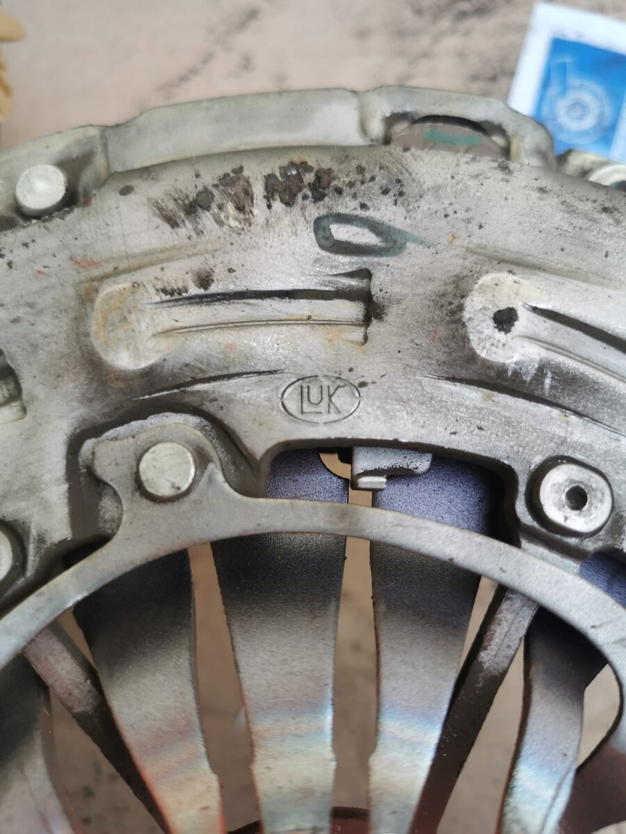

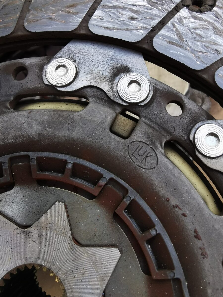

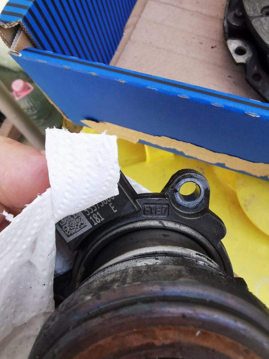

Kitul original al masinii a fost cel de mai jos:
Old_1.thumb.jpeg.74aa4647f7a31322976529ac2503d507.jpeg  Old_2.thumb.jpeg.823bb85f3cb743fb0c30ce8f515cc284.jpeg Old_3.thumb.jpeg.f3edf9c2633f5748da7d00f017e2b85d.jpeg
Deci, as putea zice "schimb 1:1" =)).
Asa cum ma asteptam, rulmentul era kaput, dar placa si discul inca mai mergeau lejer 20.000-30.000km.
