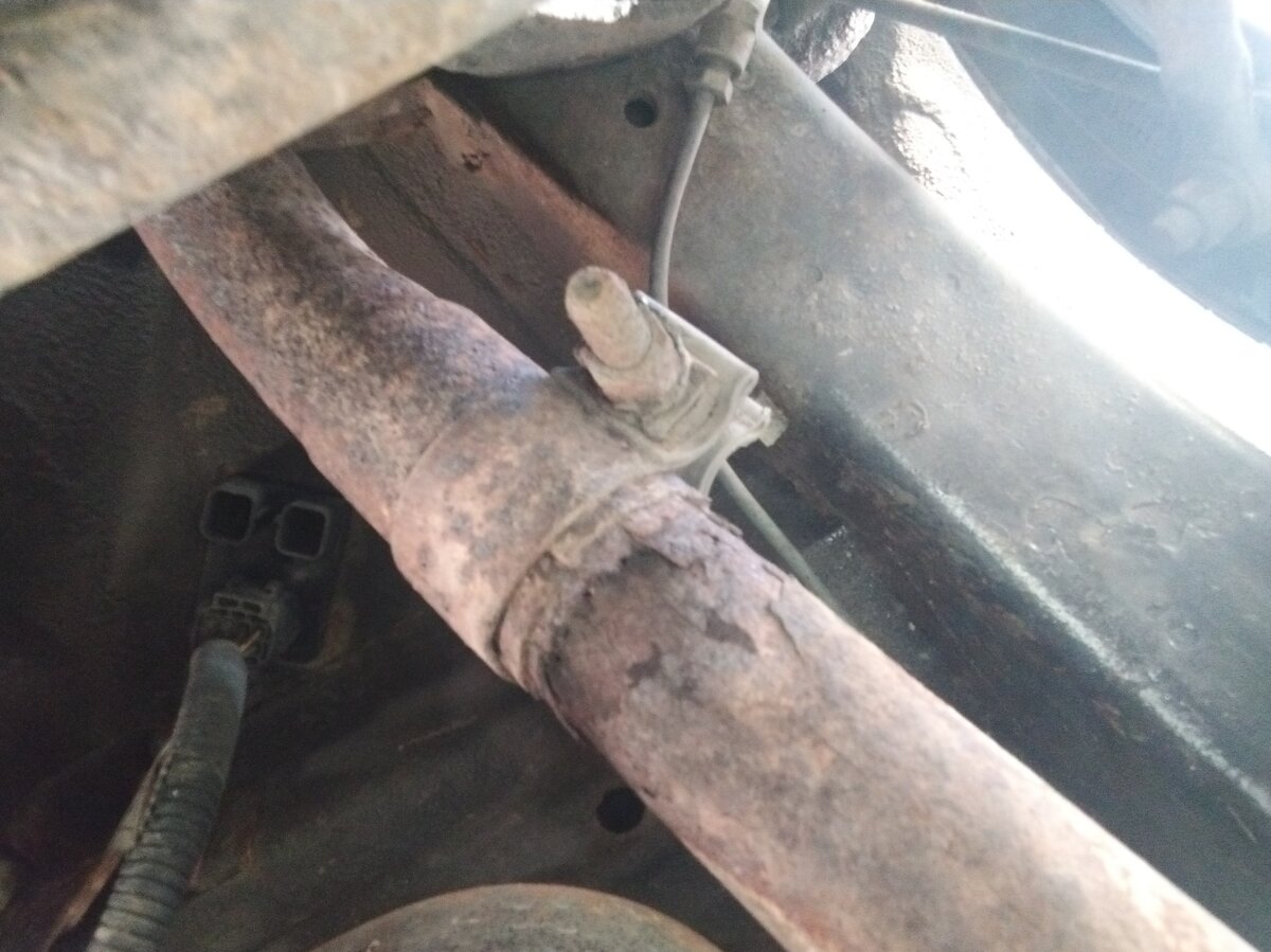

- I went to a muffler shop and the guy who inspected it showed me underneath what he found. While showing me the rotted part, and scraping the rust off the pipe with a screwdriver, he poked a hole into the pipe 😄 It was going to rust through soon anyway, so I'll take it back to replace the pipe and middle muffler on Monday.

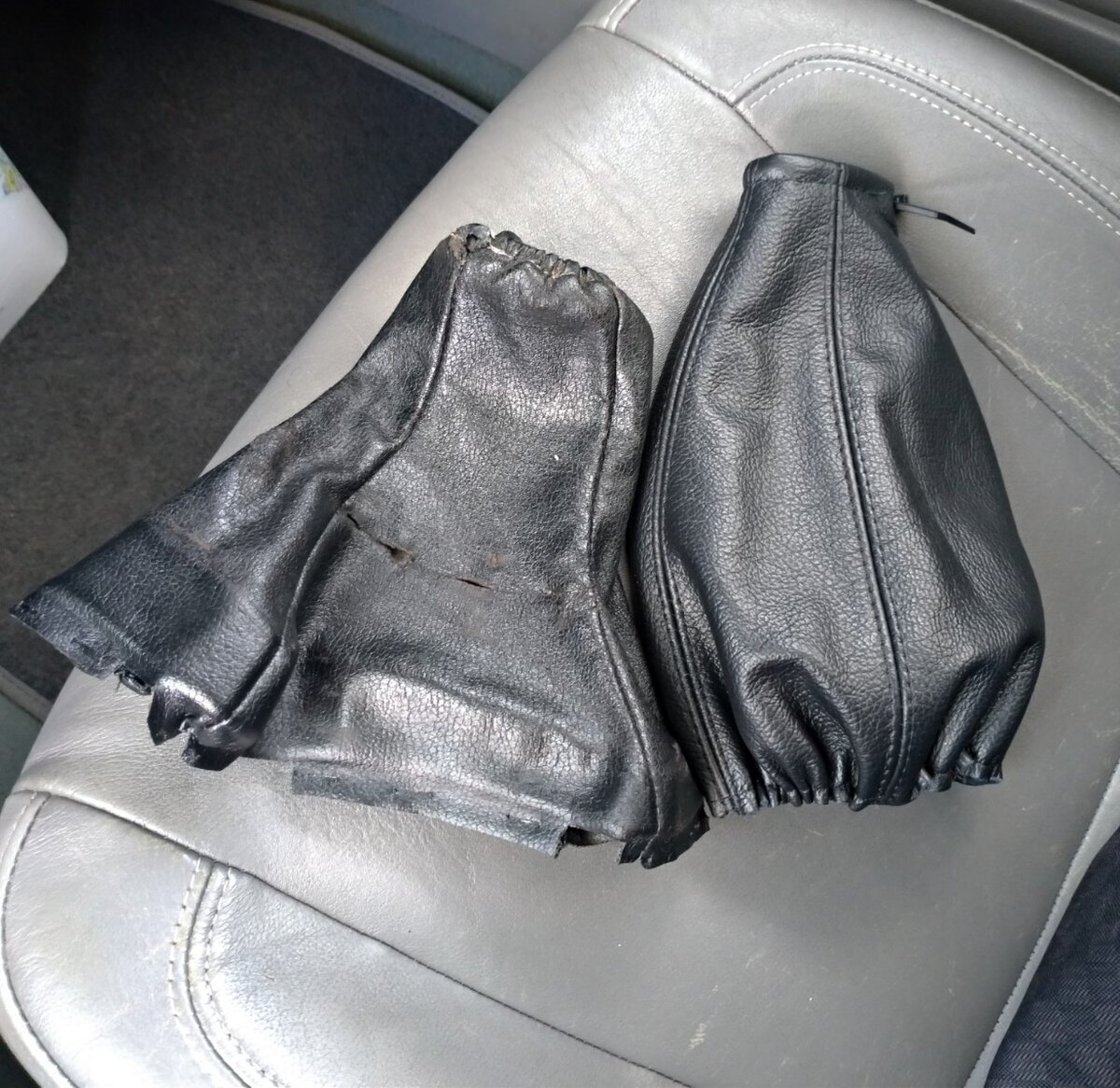

- I also bought a new front grille which will be replaced when the hood is going to be repainted - hopefully this fall. I got a new leather gear shift boot which was advertised as correct size for this model. It's not. Even when I cut some of the sewing and rubber on the skirt's bottom, I couldn't drag it onto the frame. I guess I'll have to take it to a car upholstery shop maybe they can do something with it, or make a new skirt themsleves. On the picture the left one is the old one, it's ruptured.

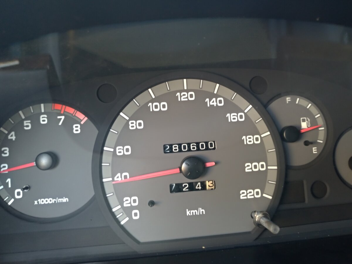

Also we made it to 280 600 km, nice round number 🙂

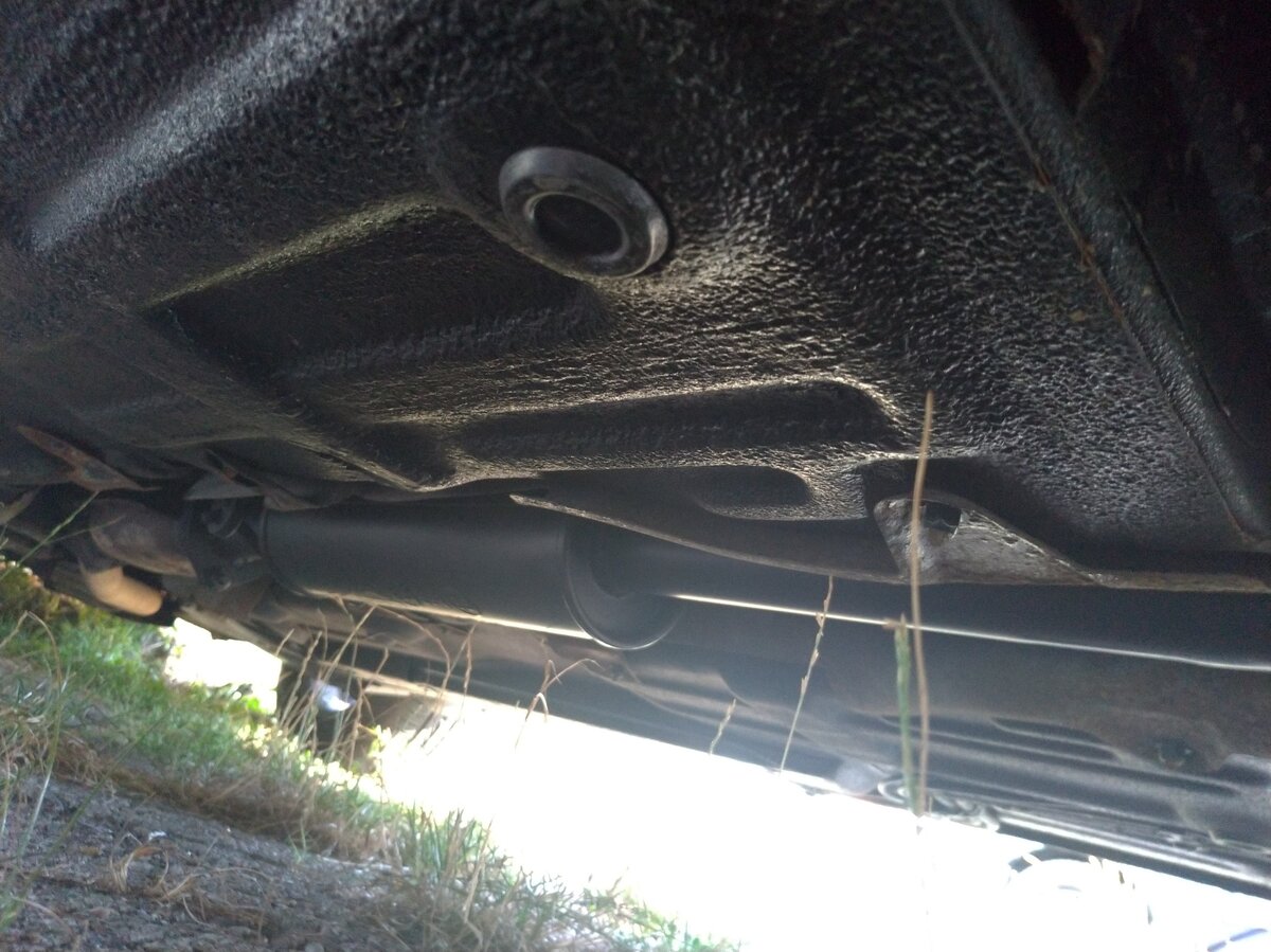

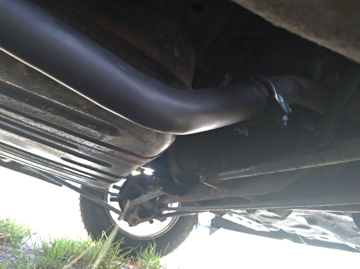

Salutare!
The exhaust pipe with the middle muffler has been replaced with thick metal that was protected. He ordered one from a muffler wholesaler, but the folding was leaking on the middle muffler, so the guy made it himself. Anyway, it looks nice.

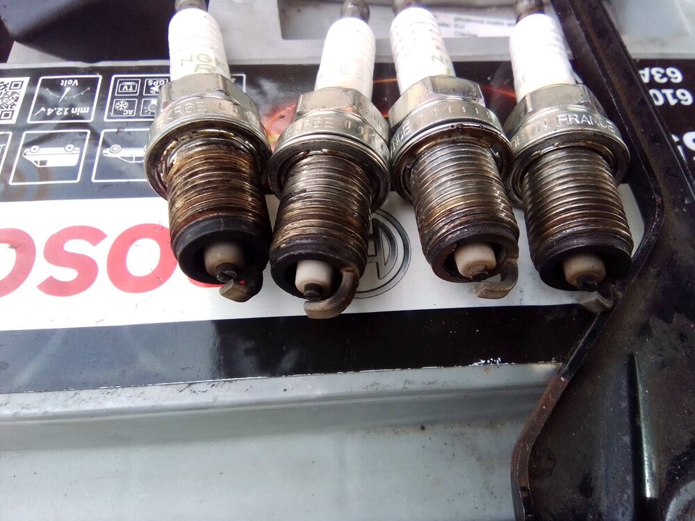

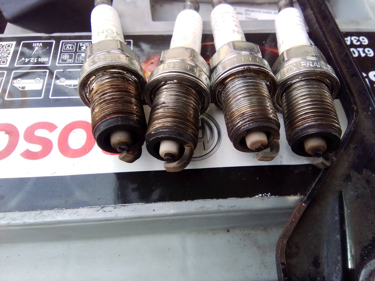

Little update: ignition coil was replace. Spark plugs from cylinder 2 and 3 looked nice, but the plugs from 1 and 4 were much worse. The guy who checked it said that spark plugs 2 and 3 are ignited at once, and 1 and 4 again at once. So he thought the ignition coil was bad, and replaced to another used original GM part, since we couldn't find a new original GM one. The catalytic converter was also replaced to a new one, since it was toast due to bad ignition. (In the picture they are in order; 1-2-3-4)

Today morning I visited a friend who has Scan-100. There was no code whatsoever, and every value was perfect, except one. The O2 sensor was totally wrong, it jumped from lean to right all the time, and the values it gave were incomprehensible. The diagnosis was that due to the bad cat (melted insides) and the replacement of it (the pounding which came with it), the O2 sensor was comprimised with metal catalysts dust from the old cat. If I'm lucky it will burn off after a few hunderd kilometers. If not, I'm in for an O2 sensor replacement, wich isn't that bad.

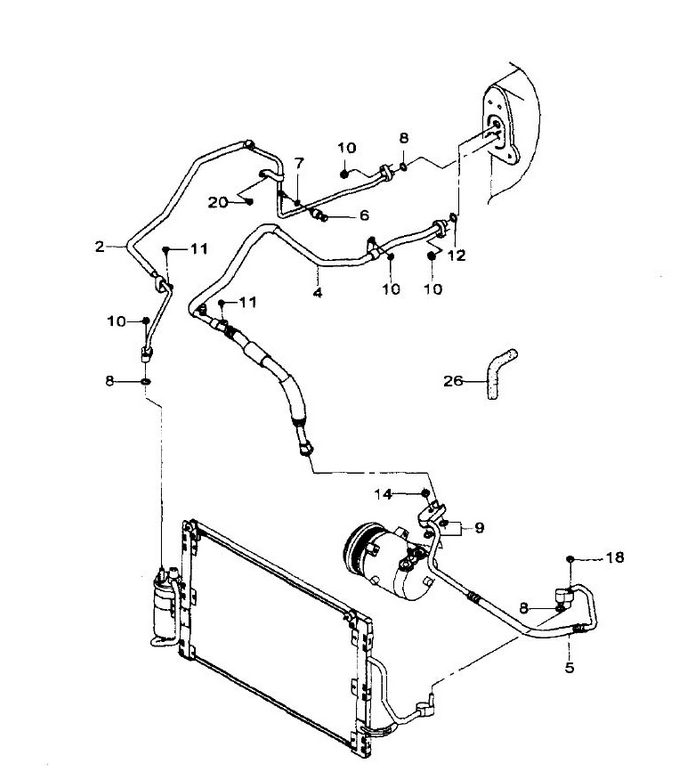

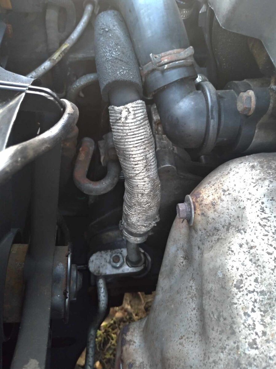

Currently I'm trying to find a 30 (or 32?) mm diameter flexible tube that has seen better days on my engine. I cannot find it anywhere. I asked in the Hungarian Daewoo club and someone said it isn't even possiible to replace it without disassembling the A/C system. Is there something I can replace this tube?
406524682_1195105597958406_4600045856450645133_n.thumb.jpg.4063897abacadc9d2f3b9561fab485cd.jpg

Well, you could replace that entire AC pipe. It's not that complicated. Just recover the freon, take a few bolts and that's kind of it. The part number is: 96269572
It's number 4 in the picture:
