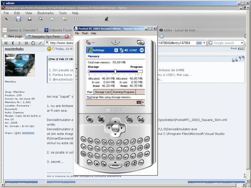

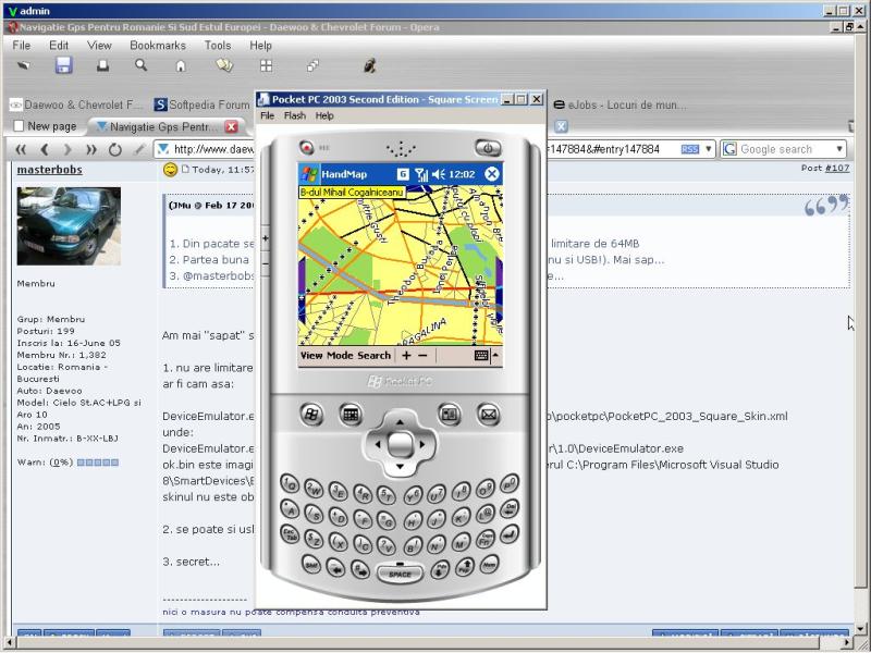

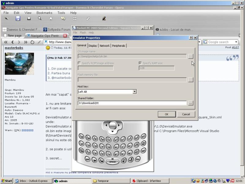

Am mai "sapat" si eu...si aproape e gata treaba:
1. nu are limitare... marirea se face din linie de comanda...
ar fi cam asa:
DeviceEmulator.exe c:\temp\pocketpc\ok.bin /memsize 128 /skin c:\temp\pocketpc\PocketPC_2003_Square_Skin.xml
unde:
DeviceEmulator.exe se afla in C:\Program Files\Microsoft Device Emulator\1.0\DeviceEmulator.exe
ok.bin este imaginea salvata si redenumita a masinii Pocket PC din folderul C:\Program Files\Microsoft Visual Studio 8\SmartDevices\Emulators\Images\PocketPC\2003\1033\
skinul nu este obligatoriu dar da bine...
2. se poate si usb...
3. secret...
post-1382-1140776028_thumb.jpg post-1382-1140776034_thumb.jpgpost-1382-1140776043_thumb.jpg
