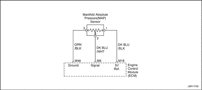

Eu zic sa incerci si cu un scaner, sa vezi cum stai cu vacuum-ul in galeria de admisie. La ralanti trebuie sa fie sub 30KPa. Eu banuiesc ca mai exista o pierdere de vacuum pe undeva. Racordul de la corpul de clapeta catre Senzorul de vacuum (MAP Senzor) l-au verificat mecanicii? La mine a fost primul care a cedat. Extras din manual: The Manifold Absolute Pressure (MAP) sensor measures the changes in the intake manifold pressure which result from engine load (intake manifold vacuum) and rpm changes. The MAP sensor converts these changes into a voltage output. The engine control module (ECM) sends a 5-volt reference voltage to the MAP sensor. As the intake manifold pressure changes, the output voltage of the MAP sensor also changes. A low voltage (high vacuum) output of 1 to 2 volts is present at idle. A high voltage (low vacuum) output of 4.0 to 4.8 volts is present at wide open throttle. The MAP sensor is also used under certain conditions to measure baro-metric pressure. This allows the ECM to make adjustments for altitude changes. The ECM uses the MAP sensor for fuel delivery and ignition timing changes. Se poate masura tensiunea la conector (terminalul 2 din mijloc) - este cam 4,8V cu motorul oprit si aprox. 1,5V la ralanti. O problema la senzorul de clapeta ar genera un cod de eroare in mod normal.
