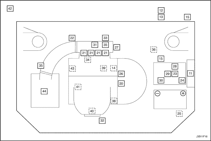

Hello, The ECT sensor for Lacetti 1.4 engine is under the intake manifold. It's not very easy to reach with the engine on the vehicle, unfortunately. I guess it's easier to access with the throttle body taked out. (It's position no. 34 on the attached diagram.)
