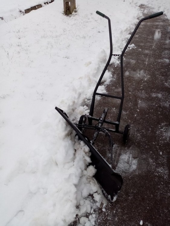

adrian_r5 Posted December 2, 2019 Share Posted December 2, 2019 24 minutes ago, Viktor said: azi la primul omat, Azi la Budapesta ... zapada asta ? Link to comment
Viktor Posted December 2, 2019 Author Share Posted December 2, 2019 5 minutes ago, adrian_r5 said: Azi la Budapesta ... zapada asta ? Da, si inca ninge. Ii fain, cel putin mie unu imi place. De s-ar pune vreo juma' de metru macar .. 1 Link to comment
Dj_Dark Posted December 3, 2019 Share Posted December 3, 2019 😄 Te mananca palmele asa-i? Mai merge agregatul? Link to comment
Viktor Posted December 3, 2019 Author Share Posted December 3, 2019 2 hours ago, Dj_Dark said: 😄 Te mananca palmele asa-i? Mai merge agregatul? Abia astept sa ninga iar, de-a dreptu o provocare ! 😀 La care din agregate faci referire, ca le-am pierdut numarul ... Link to comment
Dj_Dark Posted December 3, 2019 Share Posted December 3, 2019 Pai ala ultimul de mai sus 😉 Link to comment

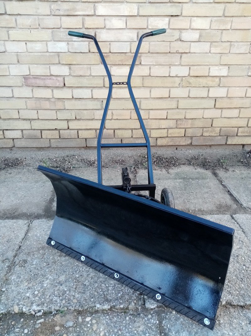

Viktor Posted December 3, 2019 Author Share Posted December 3, 2019 Merge bine, se incadreaza in asteptari, curata suficient de bine, usor de manevrat, o ia la sfert la prima ora ... omat sa fie ! 1 Link to comment
Viktor Posted December 15, 2019 Author Share Posted December 15, 2019 Cu nitica indeminare se rezolva. Nimic extra, simpla si eficienta. Link to comment

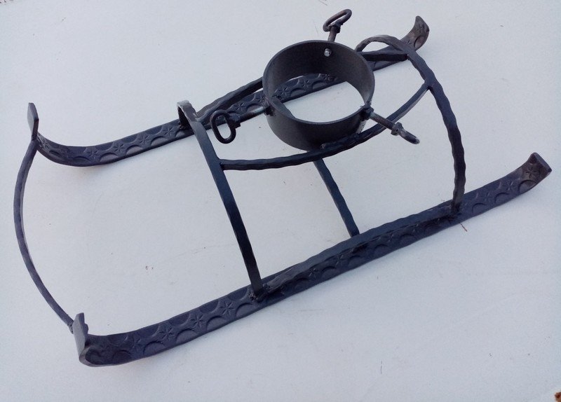

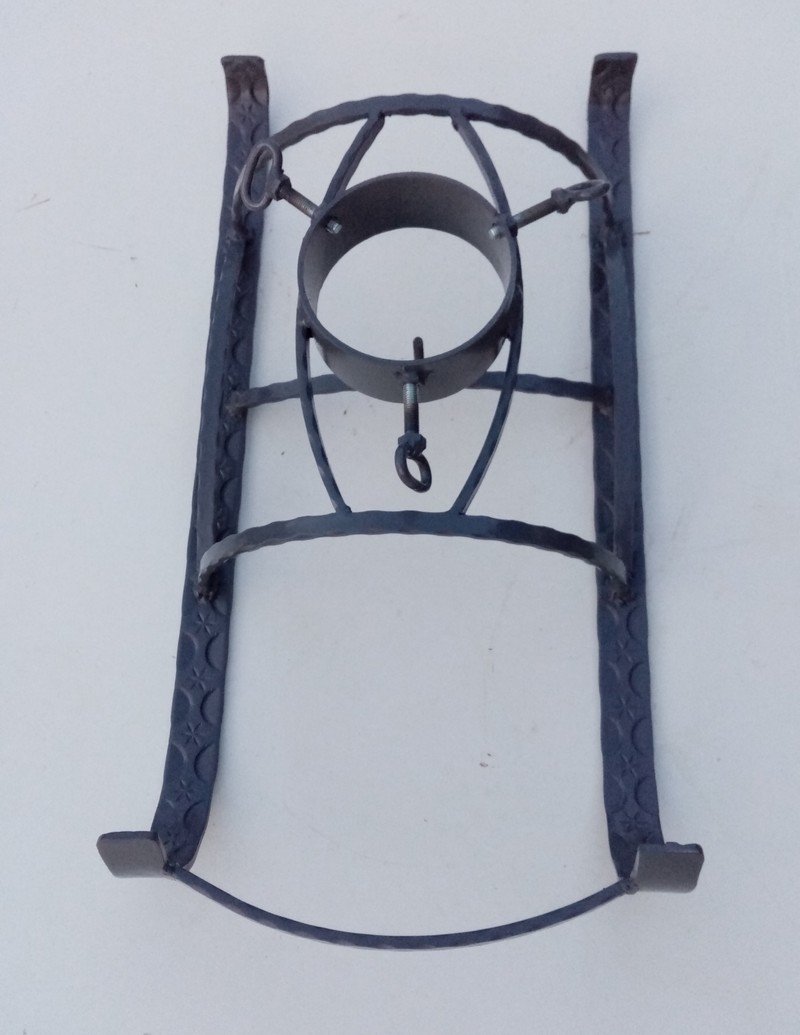

Viktor Posted December 20, 2019 Author Share Posted December 20, 2019 (edited) O "potcoava" o am, imi mai trebuie trei si calul. Cu alte cuvinte, suport pentru brad de Craciun mi-am facut, mai trebuie brad, insztalatie si dulciuri. Astea le las la mila lu' Mosu' ... Edited December 20, 2019 by Viktor 1 Link to comment

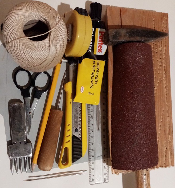

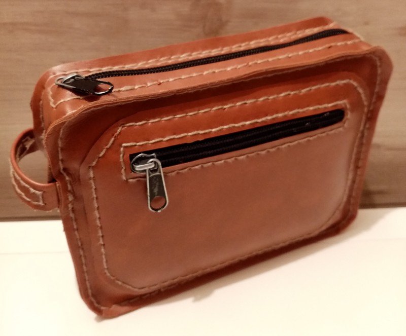

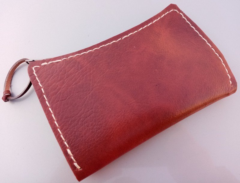

Viktor Posted February 4, 2020 Author Share Posted February 4, 2020 Borseta "di cheli" cusuta de mina, un pitic ce ma bintuie demult. Cu scule anapoda si experienta zero ... macar mi-am facut damblaua ! 3 Link to comment

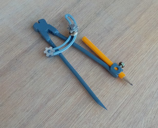

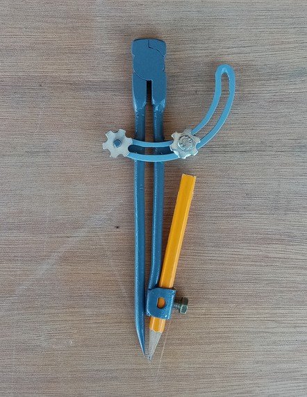

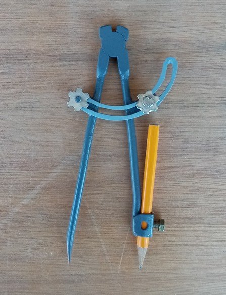

Viktor Posted February 12, 2020 Author Share Posted February 12, 2020 Meserie te halesc ! M-au scos din sarite compasurile astea cu surubele de industrie fina, asa ca mi-am croit unu din material de 5mm si direct cu creion si nu mine si alte prostii. Migala in confectionare da' nu imposibil. - una bucata cleste sigurante seeger sacrificat in acest scop (ca tot i se rupse virfurile) - doua suruburi lungi (filete la capete ce au fost indepartate) - 3 suruburi 4 mm plus piulite crestate - culisanta confectionata Inaltime totala compas 160mm si deschidete maxima 125mm. Cred ca o sa dorm cu el sub perna ... Link to comment

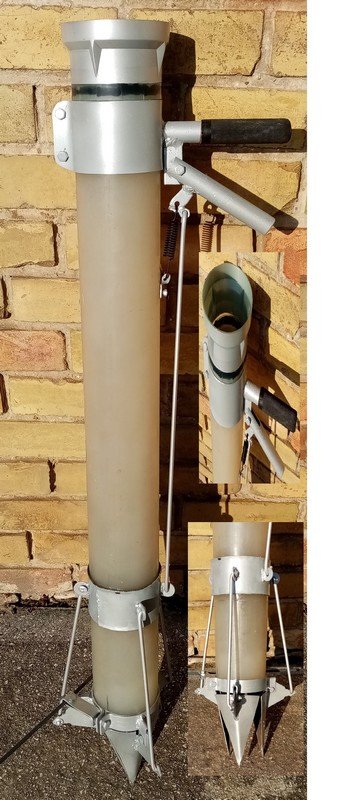

Viktor Posted February 15, 2020 Author Share Posted February 15, 2020 Pst, cine se baga la agrohome ... Mai o rosie, un gogosar, una alta ... Un pitic inca de anul trecut cu care am intirziat in a-l confectiona la timp (si a-l face cadou) asadar, ii veni timpul mult asteptatului plantator de rasaduri homemade. Link to comment

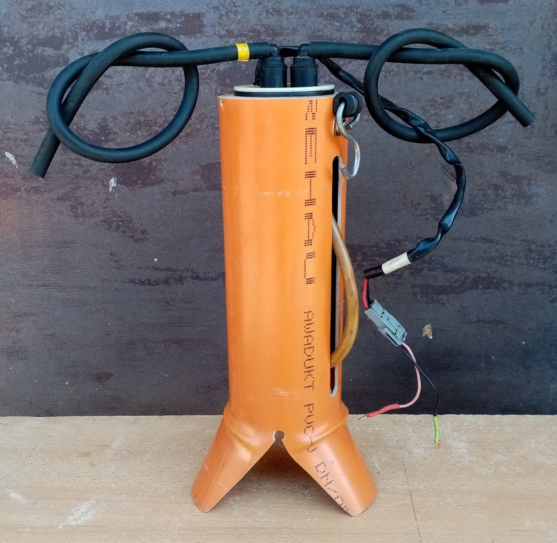

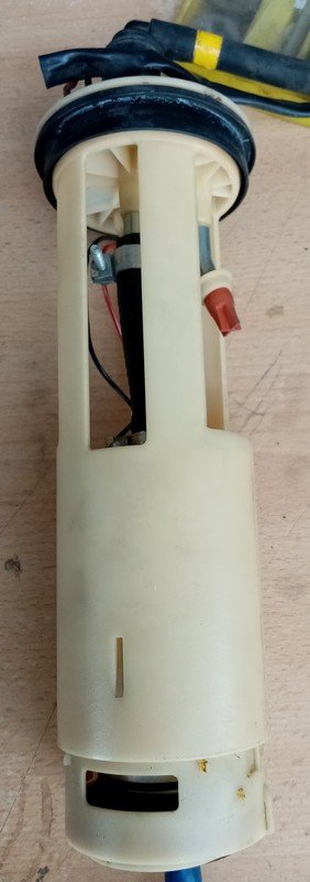

Viktor Posted April 25, 2020 Author Share Posted April 25, 2020 Am rezolvat si pompa pentru extras lichide. Ce-i drept n-aveam nici un chef a ma apuca de ea insa, odata cu efectuarea schimbului de ulei a unei motocositoare unde am constatat ca nu e pravazuta cu buson de golere a uleiului, aveam doua variante : apelez la o seringa mare si extrag uleiul prin tubulatura jojei, ori imi incerc norocul cu o pompa de benzina. Am apelat la pompa, cu o mica improvizatie rapida de test am reusit a extrage uleiul. Apoi, daca tot m-am murdari pe miini, am scos uleiul (mai viscos fiind de fel) si din compresor. Ambele uleiuri extrase la rece. Dupa toate astea am trecut la ansamblare in tubulatura picior si agatator iar furtunul transparent expus la exterior pentru a putea tine sub observatie fluxul lichidului . Furtune cu conexiuni patent si dirijabile, originale ele pompei. Daca a tras uleiul ala viscos de compresor la rece ... antigelu-i jucarie. 1 Link to comment

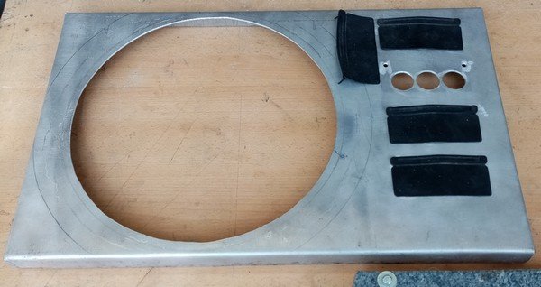

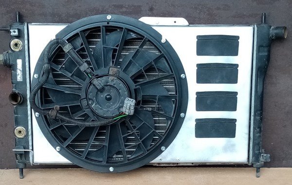

Viktor Posted June 11, 2020 Author Share Posted June 11, 2020 "Hai evribadi" Imi continui discutia inceputa aici. Se lucra, se lucra ... Una bucata tabla "haluminu" 2mm grosime trasata - croita - ondulata pe dimensiunile aferente pentru a acoperi intregul radiator si cositorite colturile cu baghete din aluminiu rezistente la 400°, apoi decupate orificiile necesare ventilatorului si ferestrele jaluzea. Bun. Urmeaza a confectiona urechile de prindere pe radiator insa, inainte de toate trebuie sa gasesc un mod de a proteja radiatorul de carcasa, un soi de garnitura in functie de grosimea acesteia sa pozitionez urechile de prindere sa cada la fix pe pozitie. Apoi montajul si conecsiunea electrica in care mi-ar suride o termocupla compatibila la filet insa in 3 pini pentru a rezolva comutarea intre trepte a ventilatorului. Relee, sigurante, cablaj etc si nitica indeminare ... avem. Cu semnul intrebarii ramine protectia dintre radiator si carcasa. Ma gindeam a folosi cheder (subtire) de usa ceva similar ... insa nu-i cunosc reactoa la temperaturi inalte, de o sa reziste ori ba. Idei ... ? 1 Link to comment
Dj_Dark Posted June 13, 2020 Share Posted June 13, 2020 Quick crash course, si ventilatorul de cielo are 2 trepte. Prima comandata de termocupla aia cu 2 pini, ailalta direct de ecm cand ajunge la 100 grade parca, (nu mai stiu exact) sau cand se scoate mufa de la senzorul cts de sub delcou (poti sa testezi) 😛 La espero e fix la fel doar ca ambele trepte sunt comandate de ecm, nu exista termocupla. De fapt si de drept ventilsatorul nu are 2 trepte, prima treapta este prin rezistentele ceramice de pe lonjeronul dreapta (daca imi aduc iar bine aminte, sau o fi stanga?) si a doua pe direct. Matematica o faci tu. Dupa mintea mea nu ai nevoie de termocupla cu 2 trepte, si ia in calcul si faptul ca si aerul conditionat are nevoie sa comande ventilatorul cand faci instalatia. Link to comment
Viktor Posted June 14, 2020 Author Share Posted June 14, 2020 Daca pina in prezent nu am sesizat doua trepte a ventilatorului pe troasca asta ... ma declar tont. Cu adevarat doua trepte pe "turbina" (ce o sa primeasca, supra dimensionata pentru amaritu' ala de radiator) abia acum o sa aiba, asa cum ar trebui sa fie cu alimentare direct din baterie prin cabluri sanatoase, sigurante, releu pe fiecare treapta si comenzi direct din senzor/i termocupla. Asta ar fi reteta corecta si sanatoasa a unui consumator sanatos si nu fineturi de ECM si alte "bulset'uri) ce dau dureri de cap aiurea. Au sfeclit-o tintarii si alte insecte bengoase de bintuie prin fata radiatorului ca n-o sa mai ramina infipti in radiator, ci tii scot chei pe partea cealalta, la ce flux de aer asigura "turbina" in cauza, sar fulgii de pe ei precum paiele de la combina ! Abia astept sa o montez, doar ca mai e ceva de migaiala. Link to comment
Dj_Dark Posted June 14, 2020 Share Posted June 14, 2020 (edited) Ia in calcul si consumul la pornirea turbinei, sa nu se opreasca motorul daca e in relanti 😄 Eu la bmw-ul rosu a trebuit sa regandesc un pic strategia cand am pus 2 ventilatoare electrice astfel incat sa nu le pun in paralel fiindca atunci cand intrau ambele pe treapta 2 mi-era ca moare 🙂 Oricum se vede la iluminatul interior cand pleaca, are o fluctuatie, imi inchipui cum era cu ambele in paralel. PS, ECM da comanda la releu, nu direct la ventilator, treapta 2 este "releita" si "sigurantata" de fabrica direct din baterie. La espero asa e si treapta 1 insa la cielo termocupla aia comanda direct treapta 1 desi are si releu (folosit doar pentru comanda de la AC) , o prostie dupa parerea mea, drept urmare eu cand am pus sfi-ul pe espero bej am modificat circuitul ca termocupla sa comande releul de treapta 1, nu direct ventilatorul. Binenteles ca asta a generat o noua problema, cand cupla termocupla actiona si ambreiajul compresorului de aer odata cu ventilatorul, drept urmare am intercalat o dioda acolo pentru rezolvare. Edited June 14, 2020 by Dj_Dark Link to comment
Viktor Posted June 14, 2020 Author Share Posted June 14, 2020 (edited) Adevarul e ca am ceva retineri in ce priveste relantiul. Paletul astuia fiind cu 10 cm mai mare fata de original si ocupa aprox. 75% din suprafata radiatorului ... nu-mi ramine decit sa o iau babeste, pe teste, sa merg o perioasa cu treapa 1 doar cuplata si apoi cu a 2-a sa vad cum se comporta. De se comporta exemplar ramine, de nu ... mai vad eu ce combinatii ii aduc, oricum, colectorul ramine fie cu ventilatorul in cauza si prima treapta (de nu suporta doua) fie originalul si colector, fie un alt ventilator. Mi s-o pus pata pe chestia asta si n-o las balta. Nu am gasit nimic concret ca si date tehnice pentru noul ventilator. Am pe undeva descarcat manual service al donatoarei de unde probabil as culege ceva date, doar ca nu stiu pe unde-i. La urma toata ce-i in mina nu-i minciuna, cu alte cuvinte testul isi spune cuvintul. L.E. Apropo, nu am AC pe caleasca. Edited June 14, 2020 by Viktor Link to comment
Viktor Posted June 14, 2020 Author Share Posted June 14, 2020 Noroc cu un radiator cazut de pe o caleasca surioara piesa pe care sa-mi pun in practica piticu'. Am rezolvat-o si cu garnitura, am sacrificat si jupuit o pereche de fise bujii vechi, semi-taiate pe lung pentru a scoate protectia exterioara se silicon pinzat si cu nitel siloplast montate pe colector, game over, sigileaza destul de bine. Urmatorul pas transplantul, instalatia electrica si teste. Devine din ce in ce mai palpitant ! 😃 Link to comment

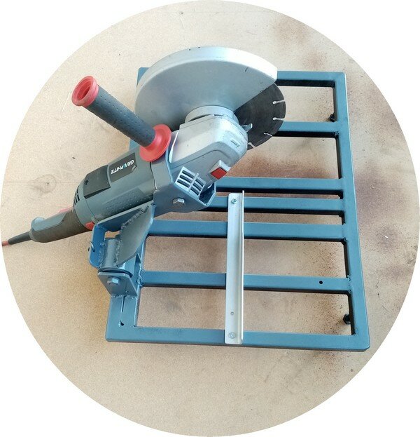

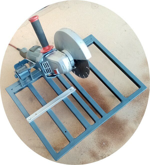

Viktor Posted October 14, 2020 Author Share Posted October 14, 2020 Dai bitangului ce-i a bitangului. Fratele mare intre flex-uri isi gasi locul "la vinclu". Link to comment
