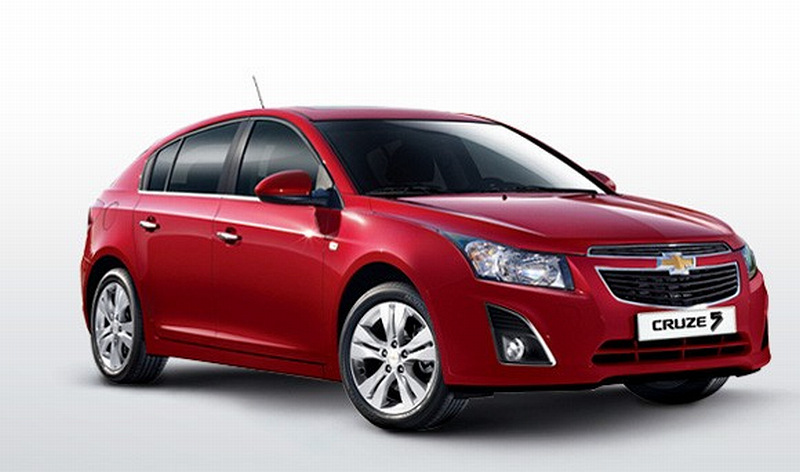

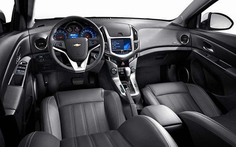

Shift1 Posted June 1, 2012 Facelift discret aplicat partii frontale a modelului Cruze, odata cu lansarea variantei break (estate) Share this post Link to post
