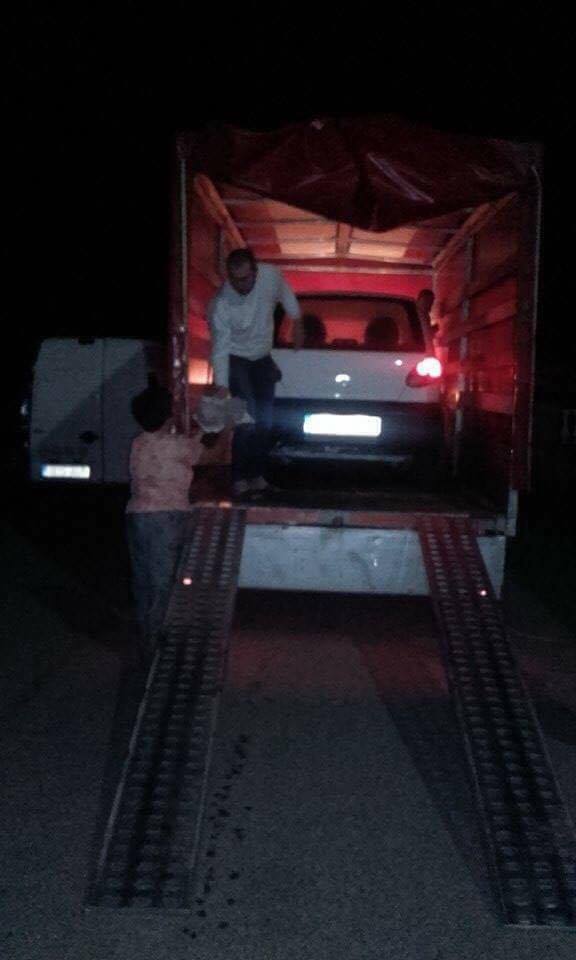

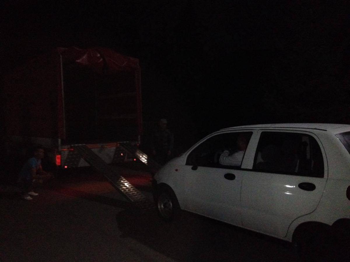

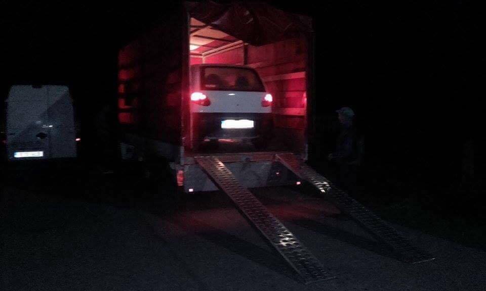

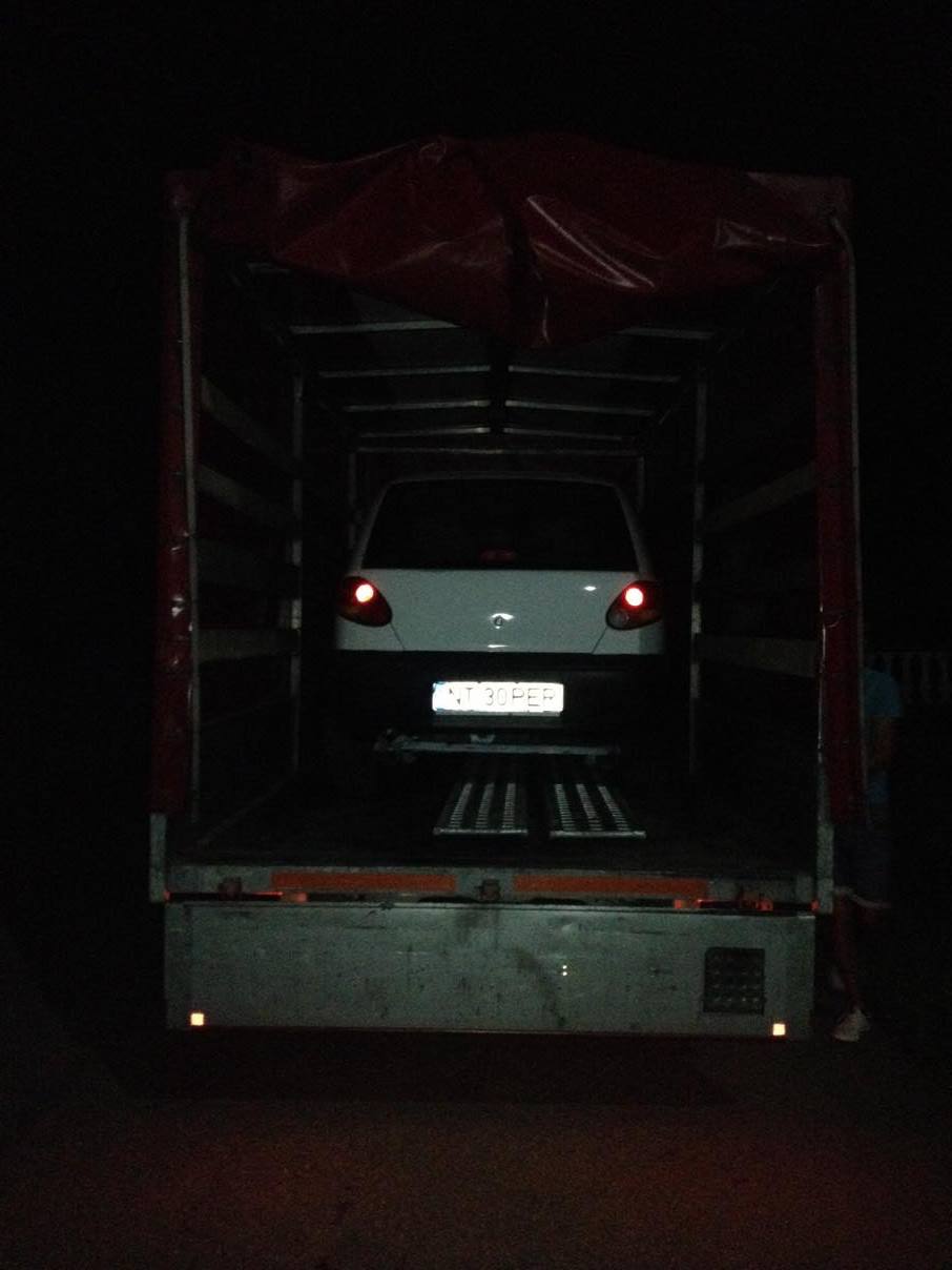

augustinionut Posted September 4, 2016 Author Share Posted September 4, 2016 (edited) Saga s-a terminat. Au plecat vineri desi au zis ca plecasera de martea trecuta (in urma cu o saptamana si). Au mers cu matizul 800 km din Fanta ca sa preia alta masina in camion. Saracul motaneata a fost condus de doi tigani ardeleni burtosi. In fine. Ma doare capul , acum imi inec amarul in bere. Edited September 4, 2016 by augustinionut Link to comment
