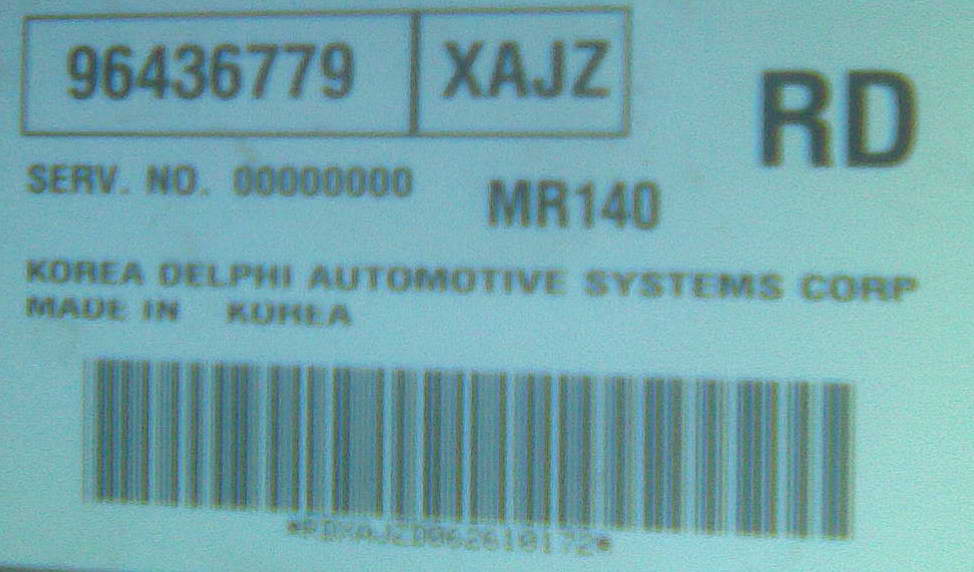

nicutz Posted July 10, 2010 Share Posted July 10, 2010 On 7/9/2010 at 5:57 PM, nicutz said: Poate mai este cineva interesat... http://www.etechchem...4-29-GM-TAC.pdf In completare Aveo, cel putin al meu, are ECM Delphi MR140. Link to comment
