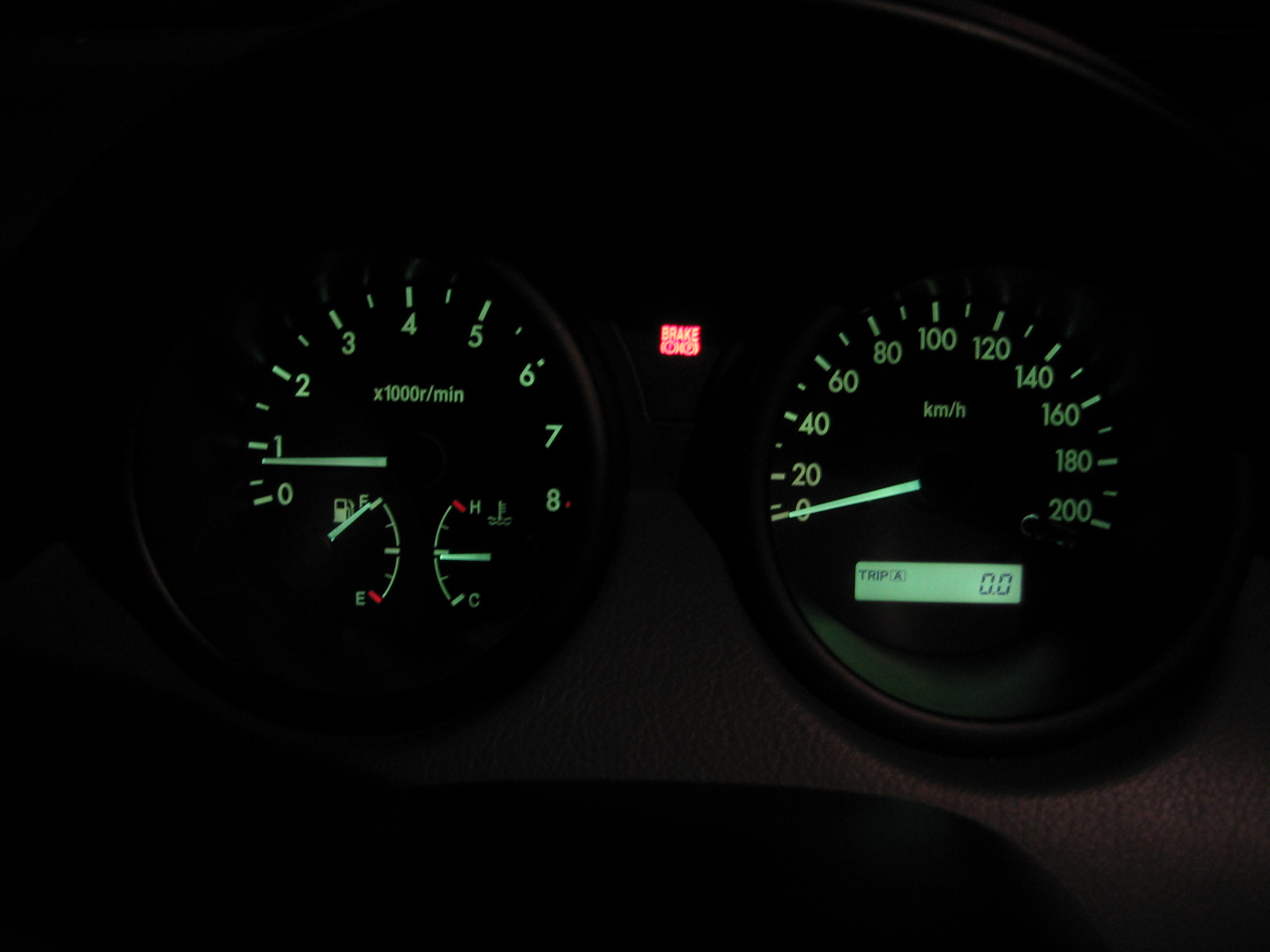

paul_marines Posted December 7, 2005 (edited) Am schimbat astazi sonda litrometrica si acul indicator si-a recapat acel sector lipsa. Intreaga operaratie a durat cca 30 min. Iata dovada. Pentru cum arata indicatorul inainte vezi post 15 Edited December 7, 2005 by safari hunter Share this post Link to post

MCojo Posted January 29, 2006 Boala cronica pe care o descriam la inceputul topicului...alimentam full, dar indicatorul in loc sa arate rezervor plin (sau ma rog putin peste plin) acul indicator era 2mm sub full! Share this post Link to post
