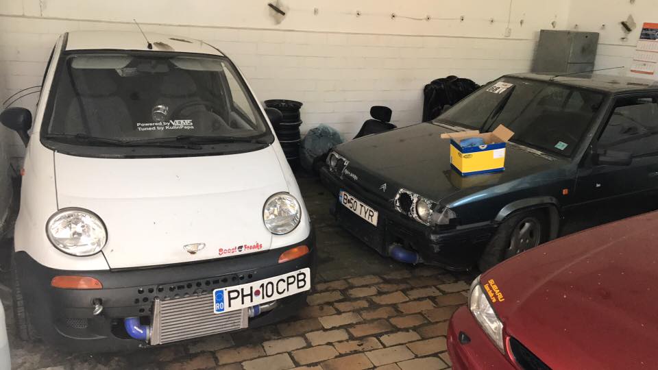

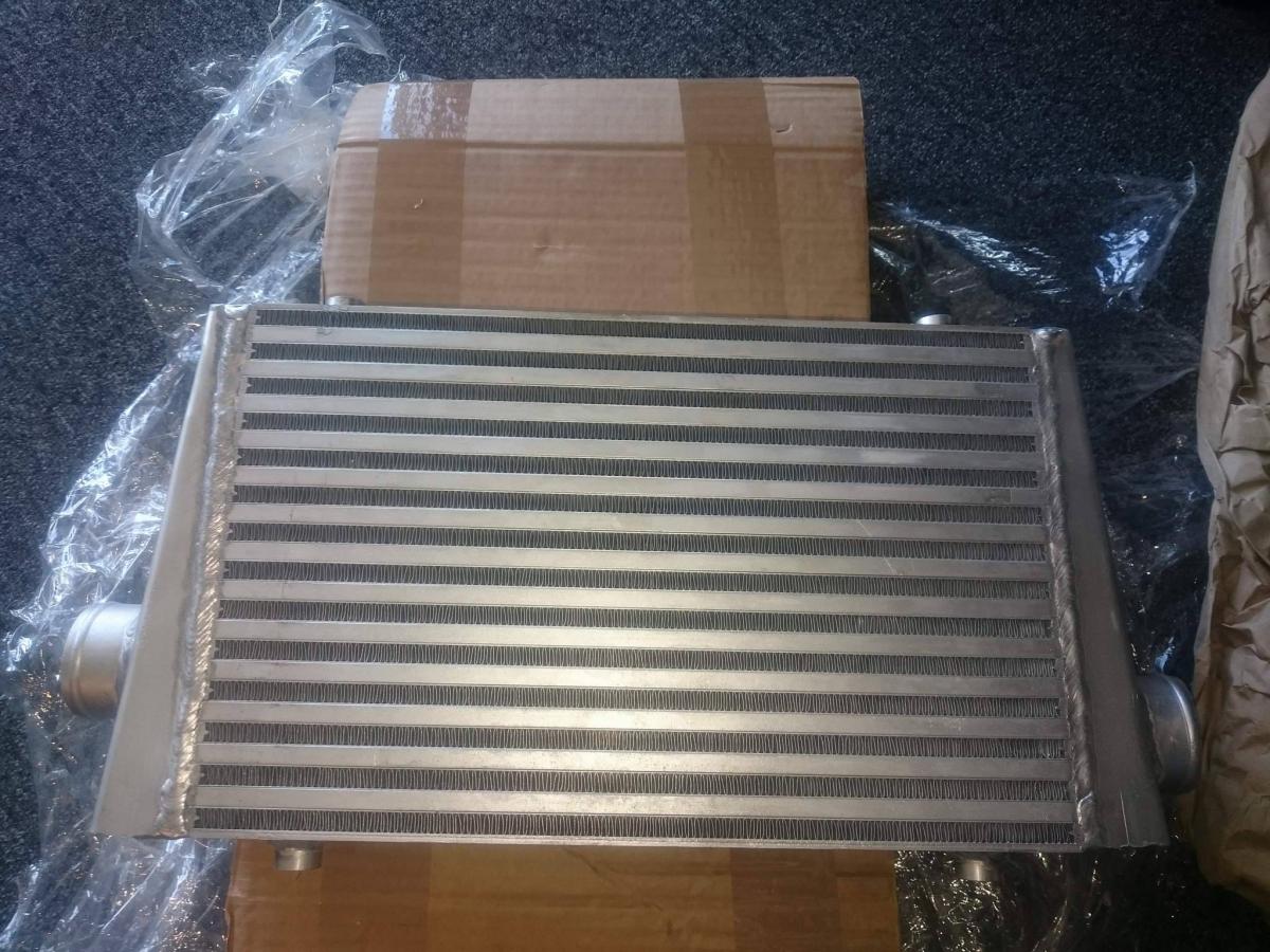

AmunDei Posted April 24, 2017 Author Share Posted April 24, 2017 Jucarii noi. Dimensiune fagure: 380*235*65 mm Cel vechi avea: 380*135 iar grosimea varia de la 50 sus pana la 60 jos. Link to comment

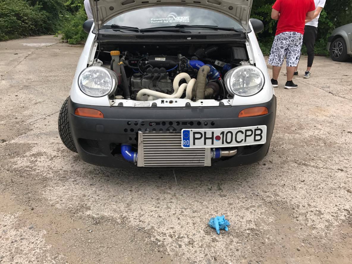

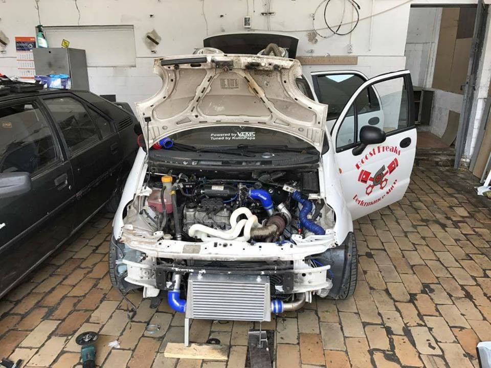

AmunDei Posted June 18, 2017 Author Share Posted June 18, 2017 (edited) O noua runda de modificari aproape completa: - kit reparatie OEM pt turbina - inca un ventilator pt radiatorul motorului - intercooler upgrade - mansoane de protectie pt fisele de bujii Si o poza in timp ce faceam probele de spatiu. Weekendul viitor la Ianca pe aerodrom la drag race. Edited June 18, 2017 by AmunDei Link to comment
