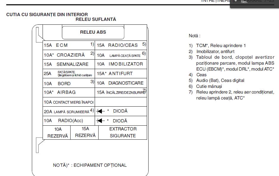

Asta e schema...alta siguranta nu are Nubira pt radio!
