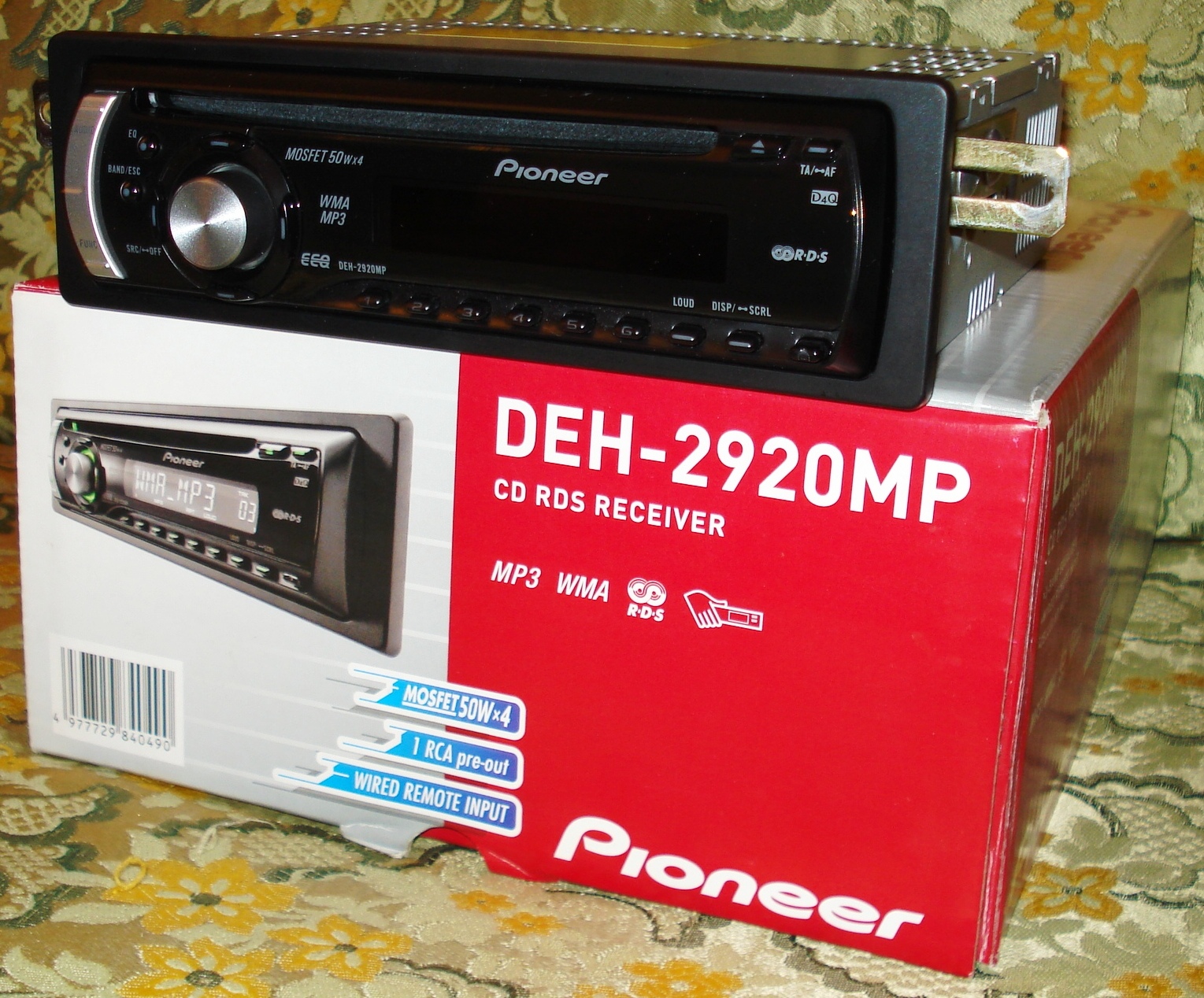

Vand Auto Radio CD Pioneer DEH-2920MP, stare perfecta, sunet excelent, inca in garantie pana in Martie 2009. Posed factura, manual si ambalaj original. Pret: 250 RON. Caracteristici: putere: 4 x 50W MOSFET (4 x 22W RMS), Radio MW / FM / LW. Compatibil: CD-R / CD-RW / MP3 / WMA / WAV / CD-text, display LCD lumina alba, iluminare taste: verde, volum rotativ, intrare muting telefon, 1 pre-out RCA stereo (2,2V), intrare comenzi pe volan (necesita adaptor), conector ISO, Radio Data System (RDS), TA / TP / AF (Traffic Announcement, Traffic Programme / Alternative Frequencies), TPY, Best Stations Memory (BSM), memorare 18 posturi, impedanta: 4 - 8 ohmi, reglaje sunet: balance, fade, Equalizer grafic presetat sau reglabil: dynamic / vocal / natural / flat / powerful / custom si separat bass, mid, treble + loudness HI si LOW, reglaj nivel surse, filtre imbunatatire sunet ptr. MP3/WMA/WAV: COMP si BMX, mute, panou frontal detasabil.
