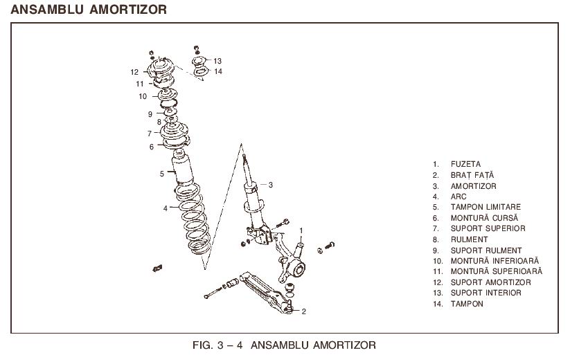

Uite-te in schema. Ala e
Edited by Pedala
Acum am inteles la ce zic ei rulment.
