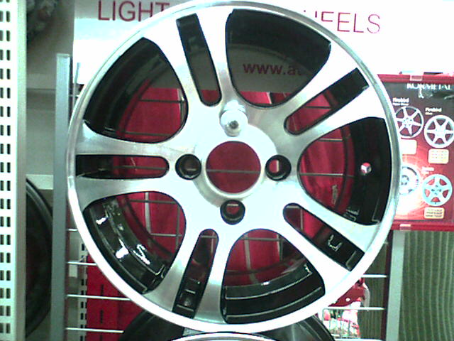

fdv Posted December 20, 2006 Salut. Am gasit in Cluj la Cora niste jante KM. Sunt pe 13, 4*100, 5.5j. Pret 230 RON / buc. Ce ziceti, isi merita banii? Multumesc. fdv Share this post Link to post
wsc Posted December 20, 2006 KM insemna Kormetal?Daca da,in Pitesti sunt 170 Ron si in Bucuresti 190 Ron. Share this post Link to post
fdv Posted December 20, 2006 @wsc - Nu stiu exact ce inseamna. Cand ma duc data viitoare ma uit mai atent. Dar daca e asa, cam mare diferenta de pret. Calitativ oare cum sunt? Share this post Link to post
Gamerul Posted December 20, 2006 (edited) KM=Kormetal=Made in Turkey Asta e link-ul pentru modelul de mai sus : http://www.kormetal.com/ingilizce/jantdetay.asp?wheel_ID=26 . Edited December 20, 2006 by Gamerul Share this post Link to post
mvylo Posted December 20, 2006 Daca "gamerul" are dreptate uita-te mai bine la ET. Mi se pare cam mic - 30! Share this post Link to post
fdv Posted December 21, 2006 @gamerul - Astea sunt jantele. @mvylo - Ce inseamna ET = 30? Multumesc. Share this post Link to post

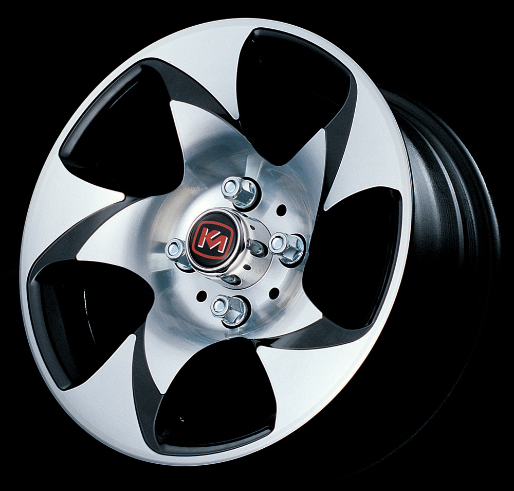

uskt2005 Posted December 21, 2006 Va rog sa imi spuneti unde pot gasi acest model de jante si la ce pret (mie unul imi plac la nebunie ) http://www.kormetal.com/ingilizce/jantdetay.asp?wheel_ID=52 Share this post Link to post
SORAN Posted December 21, 2006 (edited) Pe bulevardul Basarabia la depozitul Lassa de anvelope. (Asta in Bucuresti) Edited December 21, 2006 by SORAN Share this post Link to post

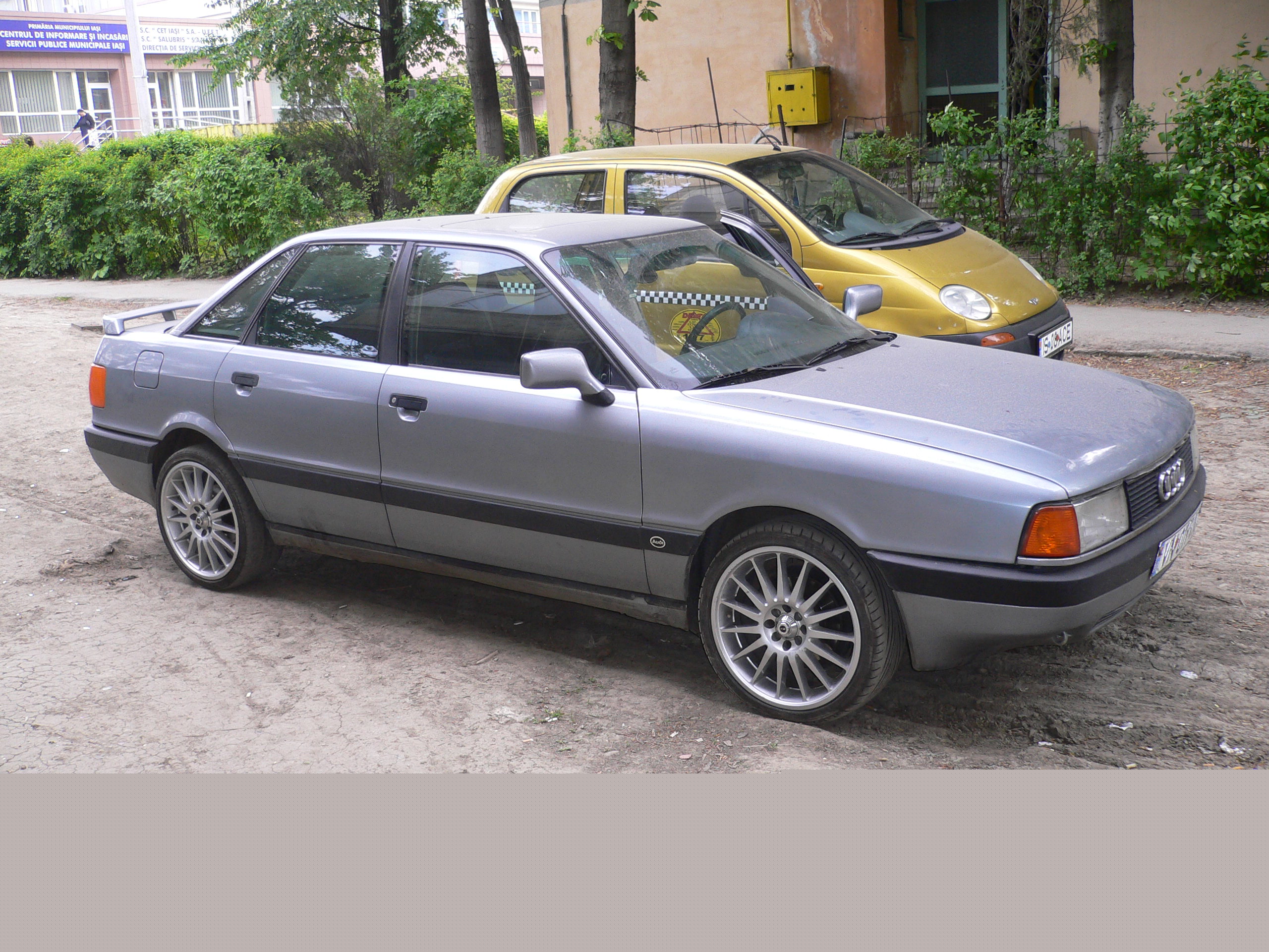

alx Posted January 31, 2007 Dasteptul ala cu Audiul din poza pusa de tine a pus cauciucul de pe fata invers... Share this post Link to post
uskt2005 Posted January 31, 2007 Sau poate cei de la vulcanizare au fost atat de "destepti" si omu nici nu a vazut Share this post Link to post
geti Posted January 31, 2007 Nu.Omu stie ca e pus invers dar l a pus cum a apucat. Share this post Link to post
uskt2005 Posted January 31, 2007 (edited) Dat fiind profilul anvelopei cred ca pe un carosabil umed o sa aiba ceva probleme cu aderenta Sfatuieste-l sa il puna asa cum trebuie Edited January 31, 2007 by uskt2005 Share this post Link to post
Englishman Posted January 31, 2007 Oricum profilul ala nu prea e indicat pentru carosabil umed, asa ca poate sa le intoarca si de 100 de ori... numai sa nu le puna de pe spate in fata ca alea sunt varza... Share this post Link to post
RaduERD Posted January 31, 2007 Nu v-ati gandit ca poate omu merge mai mult cu spatele, caz in care anvelopele sunt montate corect! ) Din cate imi dau seama dupa profil guma este GoodYear Eagle F1 GSD-3, guma excelenta pt. ploaie. Share this post Link to post
uskt2005 Posted January 31, 2007 Adevar graiesti http://www.blackcircles.com/tyres/goodyeartest Share this post Link to post

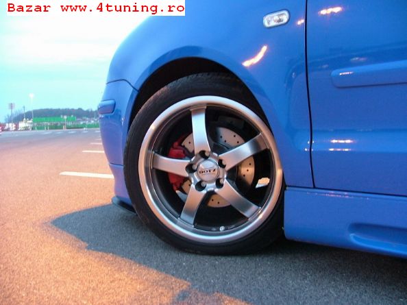

geti Posted February 8, 2007 Ce parere aveti de montarea unor jante Dotz Daytona pe cielo sau espero.Am gasit pana la urma in 4 prezoane pe 16 (5,5 mil buc).Credeti ca e bine sa fac un compromis in ceea ce priveste latimea,deoarece astea au 7j si eu vroiam de 7,5j? Share this post Link to post
Gamerul Posted February 8, 2007 Si pe 7,5J ce anvelope vroiai sa-ti pui ? Cumva 195/50/R15 ? Share this post Link to post
geti Posted February 8, 2007 (edited) Nu bineinteles ca nu.Dar de ce ?Crezi ca ar atinge?Cele de 7,5j aveau sa fie incaltate cu 205 sau 215 pe 45.Daca as pune 50 pe 16 ar da eroare in vitezometru,cred,atat pe espero cat si pe cielo si chiar daca ar rezulta un raport corect consider ca 195 e prea ingust pentru 7,5.Mersi de raspuns.P.S acum am vazut ce 195 50 pe 16 e bun ptr espero dar totusi nu cred ca sunt suficiente ptr 7,5. Edited February 8, 2007 by geti Share this post Link to post
Gamerul Posted February 8, 2007 Jantele cu latimea de 7.5J sint prea late pentru anvelopele de 195. Share this post Link to post
