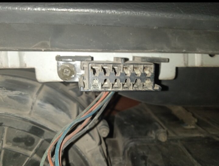

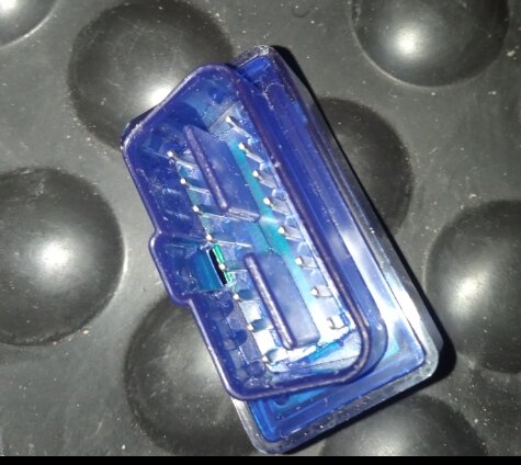

sulman Posted January 11 Is this thread & forum closed ? I can't see any recent replies or queries. I need to ask abou Daewoo Chevrolet Matiz Ls 0.8. Having quite few issues and unable to find Honest to work mechanic, so trying some DIY's. I bought elm327 old, but scanner port is not same, attaching my port picture here, can anyone identify and guide which connector I should search and elm 327 will connect to it using any jacl or cable connector? Share this post Link to post
adrian_r5 Posted January 11 (edited) 5 hours ago, sulman said: attaching my port picture here The connector of your car is ALDL ... few informations here - https://en.wikipedia.org/wiki/ALDL I know that my post doesn't answer to your question but I hope it is a point to start solving your issue. Edited January 11 by adrian_r5 Share this post Link to post
