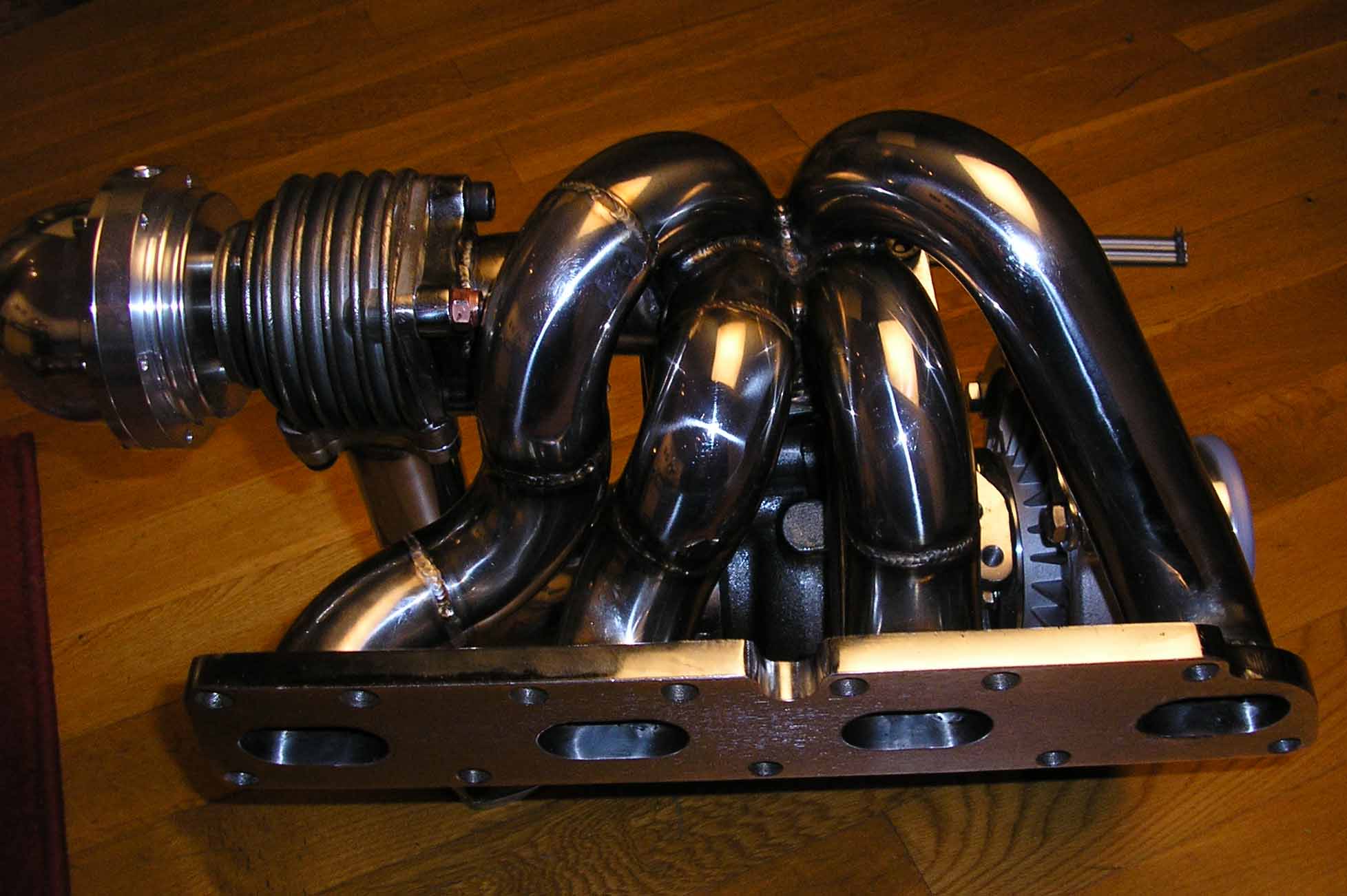

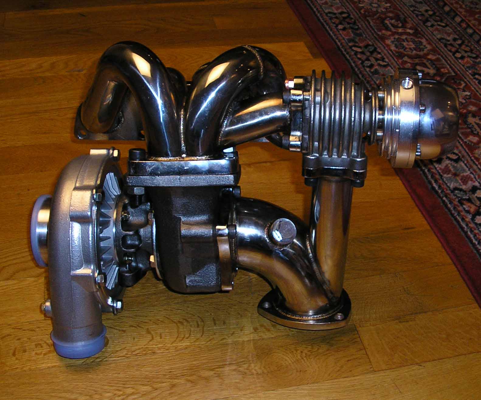

you should get one of this in your car :-) then you will have a fast lanos :-)
Unfortunatelly there is no room under the hood for that booster...
yes it is. maybe some small modification,but wee have fitted this to a nova also,and it was no problem. that one pull out 387hp on a dynopack on only 18psi. the only modifications on the engine was this turbo and manifold,H-beam rods,MLS gasket,EDS phase 4 chip and larger injectors..
It's fast enough... :lol:
Than I would have to put some casted rods and arp srews and maybe pistons... It's to expansive and there is no point on FWD...
I will have over boost about 1.3bar with stoock KKK16. It's about 280HP and it's enough for FWD...
