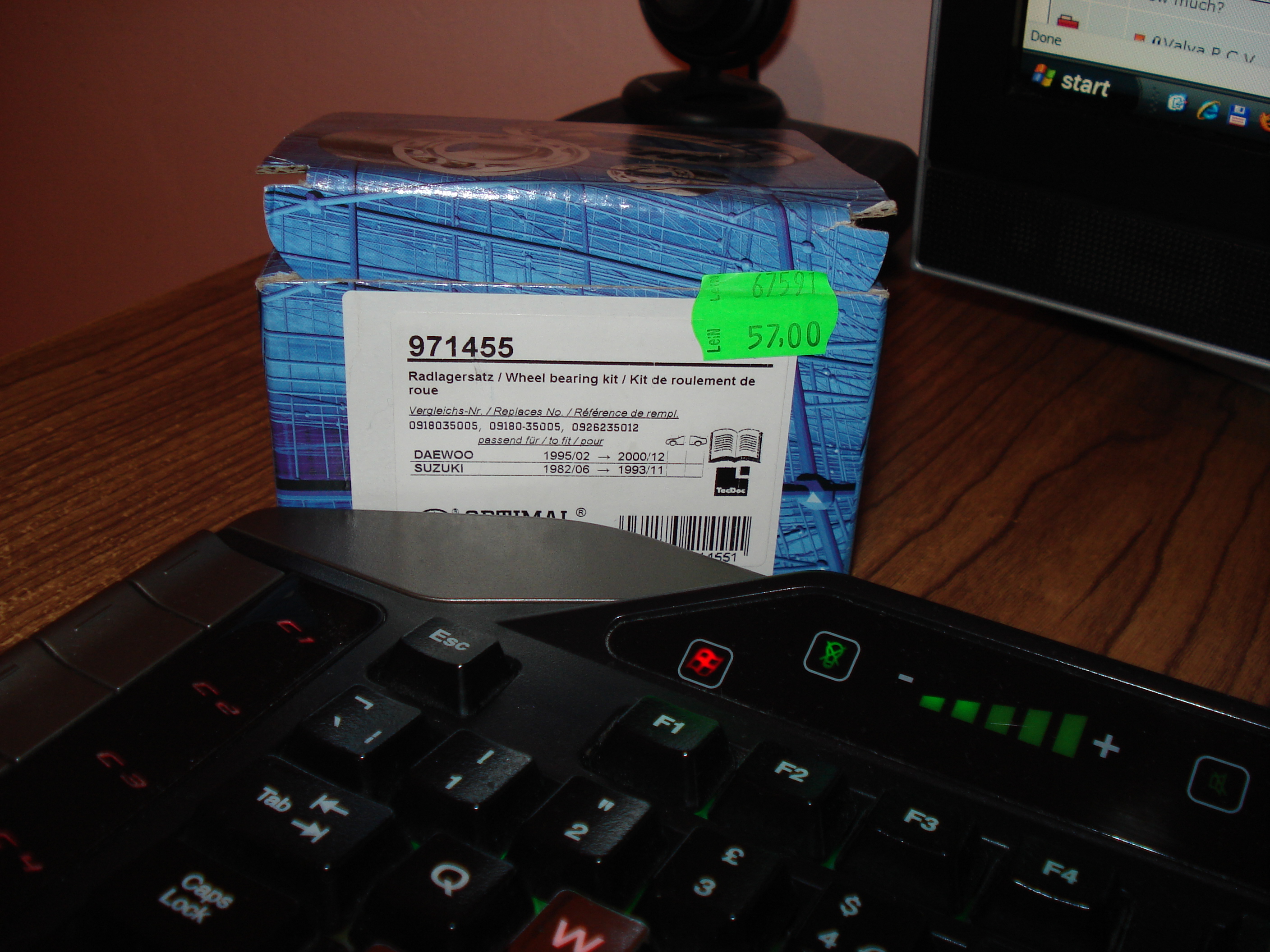

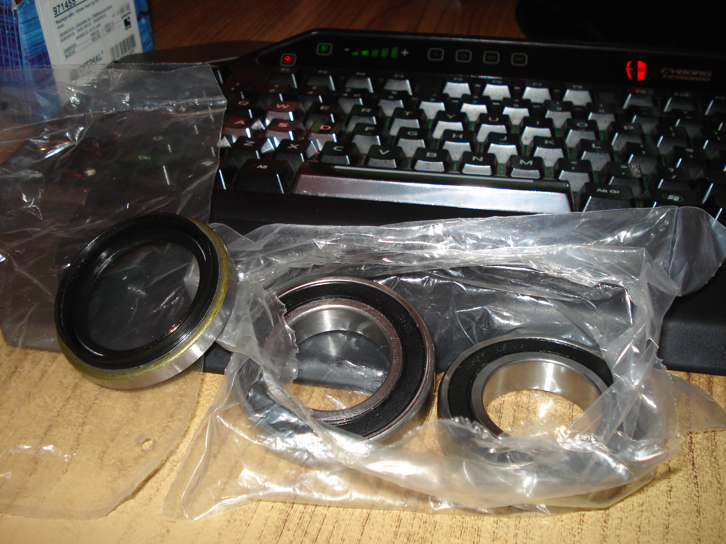

Den Posted March 31, 2009 (edited) Am urmatoarele probleme..schimbat de 2 ori pe anul asta rulmentii fata..si deja imi suna iara..culmea..amandoi.Tot ce am gasit in magazine e marca optimal in jur de 57 ron pe cutie.Pana de curand am crezut ca sunt cauciucurile mai mari pe fata de vina.Am atasat cateva poze cu rulmentii.O mica chestiune.In poza doi se observa ceva metalic in stanga..ca o garnitura.La service nu au vrut sa puna acea garnitura pe motiv ca e metalica..si au folosit de la rulmentii vechi niste chestii de plastic.Posibil de acolo sa vina necazul? Edited March 31, 2009 by Denied 1 Share this post Link to post

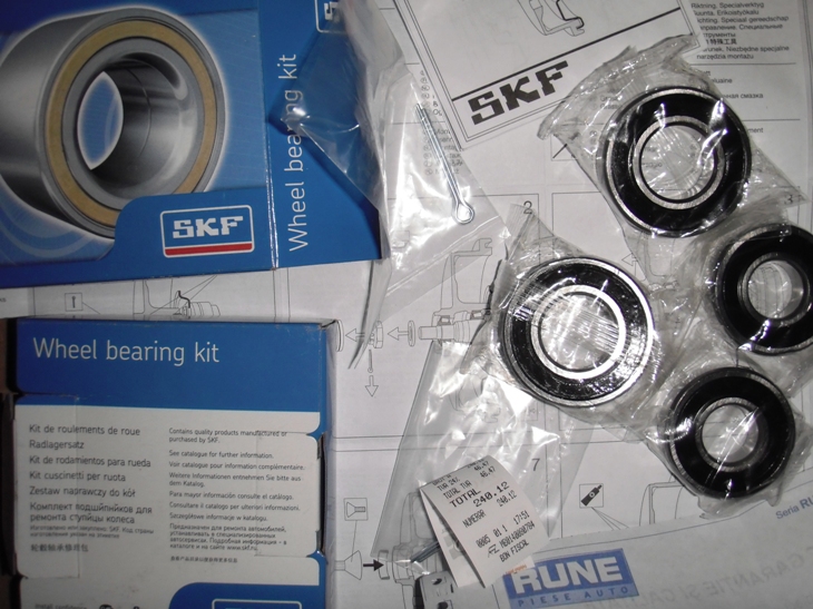

monitor Posted September 27, 2011 (edited) Am achizitionat si eu rulmentii spate pentru Ticozaurul meu. Inscriptie rulment mare -SKF EXPLORER 04 13 040H 6205 2RSH/C3 CHINA Inscriptie rulment mic -SKF EXPLORER 04 21 311G 6204 2RSH/C3 CHINA Unde gasesc un service pentru un montaj cu presa si blandete ? Am cautat vaselina adecvata pentru rulmentii de mai sus si am gasit urmatoarele variante : 1 SKF LGMT 2 - for General purpose Generally use if: Speed = M, Temperature = M and Load = M ( mediu , medie ) SKF General Purpose Industrial and Automotive Bearing Grease SKF LGMT 2 is mineral oil based, lithium soap thickened grease with excellent thermal stability within its operating temperature range. This premium quality, general purpose grease is suitable for a wide range of industrial and automotive applications. • Excellent oxidation stability • Good mechanical stability • Excellent water resistance and rust inhibiting properties Typical applications: • Agricultural equipment • Automotive wheel bearings • Conveyors • Small electric motors • Industrial fans 2 SKF LGHP 2 for High temperature Expected bearing temperature continuously > 100 °C / 212 °F SKF High Performance, High Temperature Bearing Grease SKF LGHP 2 is a premium quality mineral oil based grease, using a modern Polyurea (di-urea) thickener. It is suitable for electric motors and similar applications. • Extremely long life at high temperatures • Wide temperature range • Excellent corrosion protection • High thermal and mechanical stability • Good start-up performance at low temperatures • Compatibility with common polyurea and lithium thickened greases • Low noise properties Typical applications: • Electric motors: Small, medium and large • Industrial fans, including high speed fans • Water pumps • Rolling bearings in textile, paper processing and drying machines • Applications with medium and high speed ball (and roller) bearings operating at medium and high temperatures • Clutch release bearings • Vertical shaft applications • Kiln trucks and rollers Nu am cumparat inca vaselina . Edited September 27, 2011 by monitor Share this post Link to post
monitor Posted September 28, 2011 KIT rulmenti SKF roata fata :VKBA 3797 KIT rulmenti SKF roata spate :VKBA 1931 Share this post Link to post
